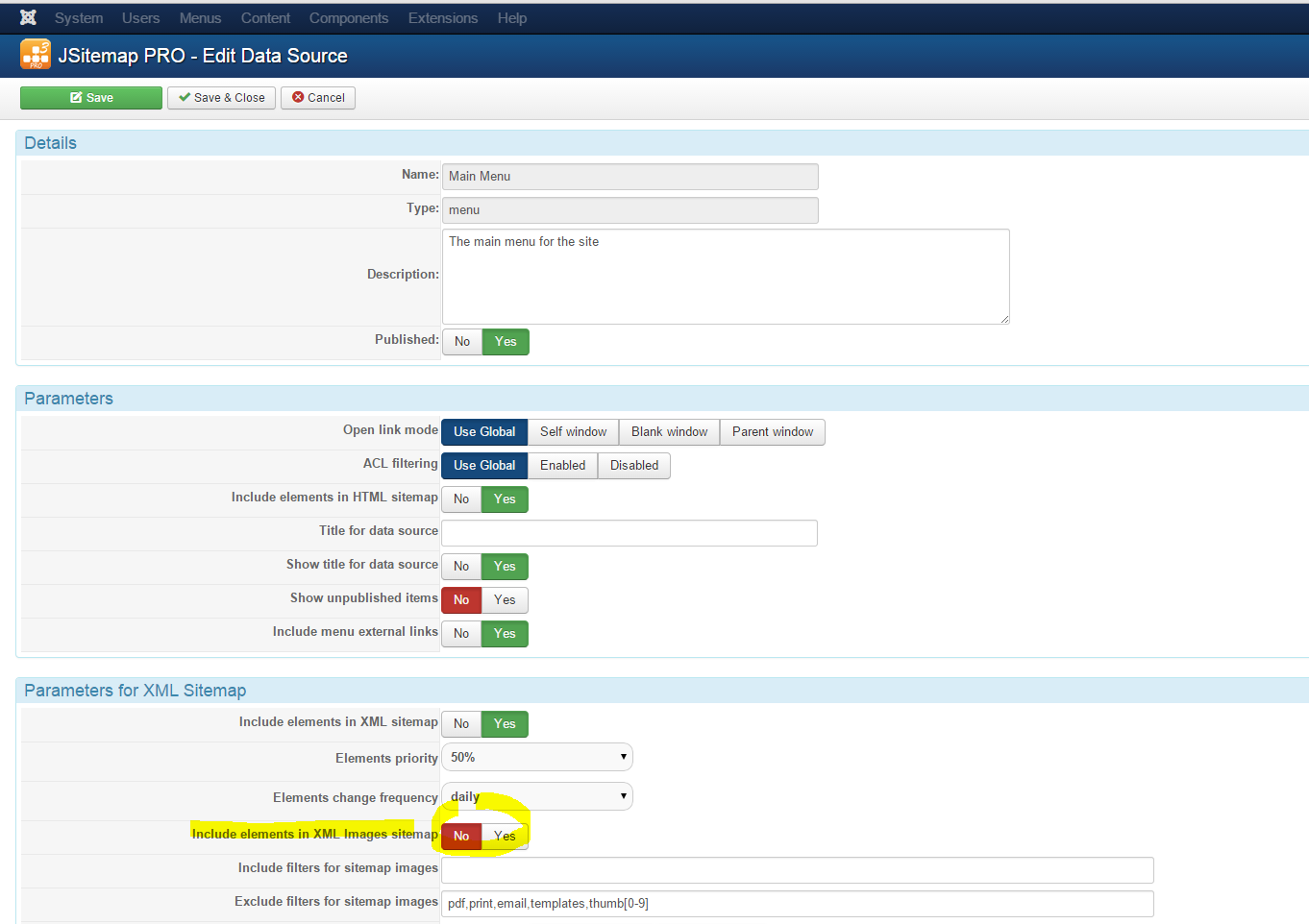

Hello gaetano,
if you need to exclude images crawled from menu links, the easiest way is exclude various menu data sources from the images sitemap, as shown below.

Re:tips for beginners Karma: 0
i try it but the menu are still index and jreview don't index

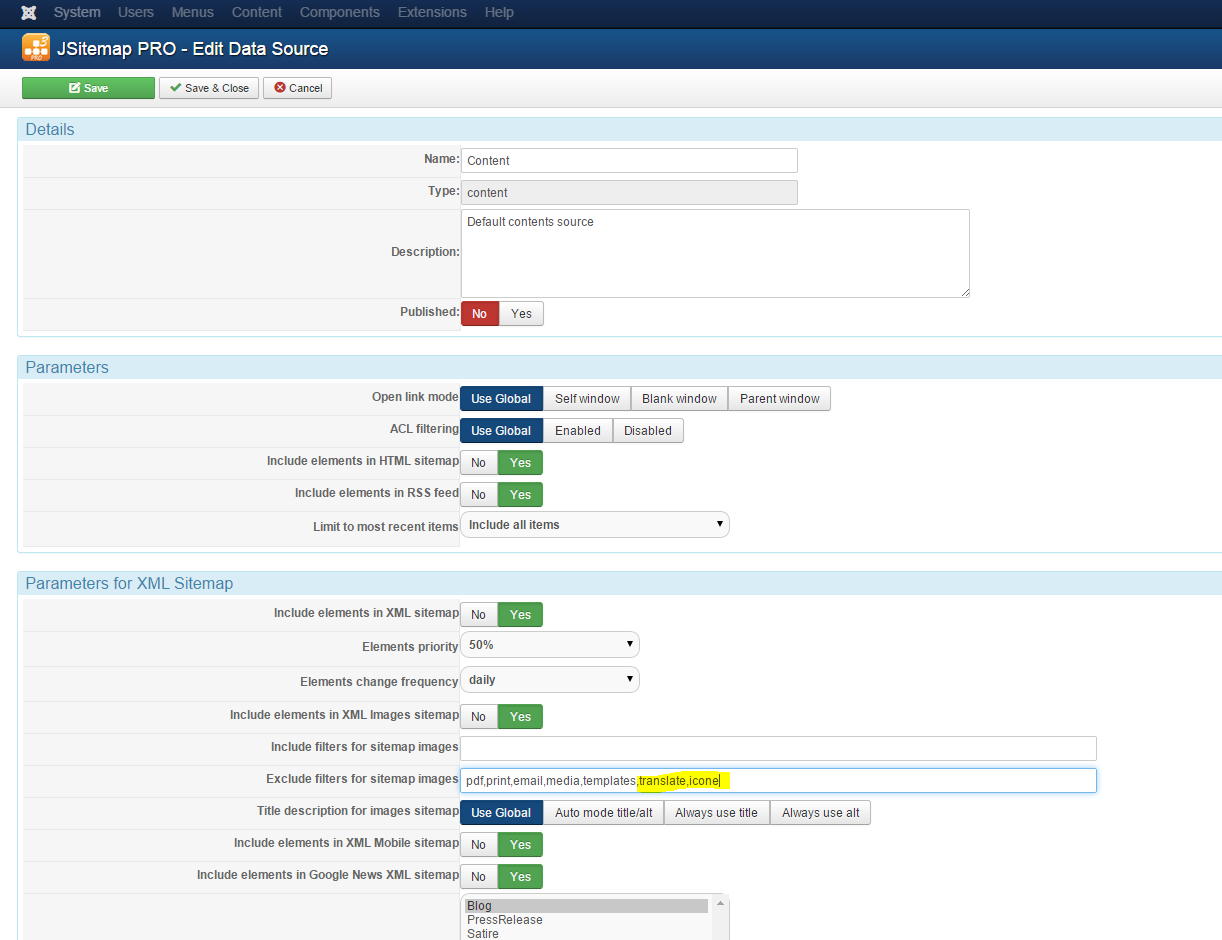

http://www.visitasicilia.com/modules/mod_gtranslate/tmpl/lang/blank.png http://www.visitasicilia.com/images/nuove_icone/guida vacanze sicilia mobile.png http://www.visitasicilia.com/images/nuove_icone/guida vacanze sicilia.png

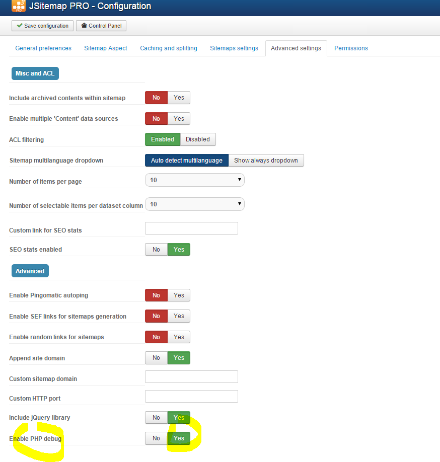

and i found an error when i click on "analyze sitemap links" i get a blank page

Add more exclusions filters comma separated to exclude those images,
see below screenshot, for example 'translate' and 'icone'

Re:tips for beginners Karma: 84
The blank page could hide a php error on server, try to enable the component debug before start the Links Analyzer and eventually even the error reporting in Joomla global config
