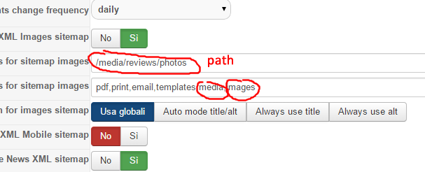

ok i understan but I'm a little confused.
i want index alone this: /media/reviews/photos
i don't want index it: /images
is correct the setting in the pictcure

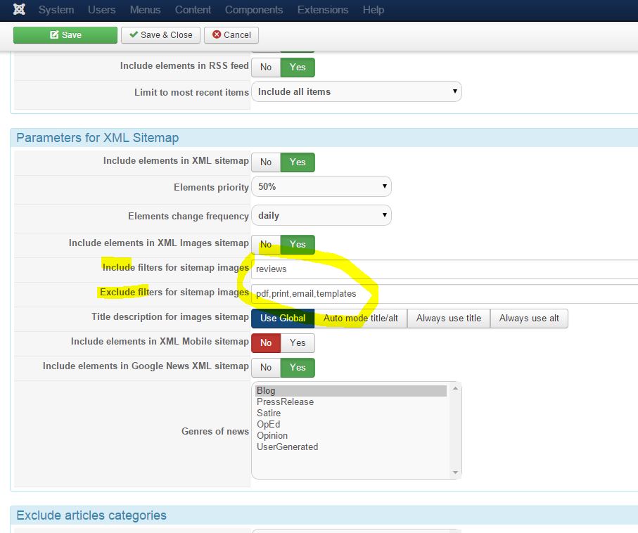

Re:tips for beginners Karma: 84
it's not required add the full path to the include/exclude filters, it's enough set only a subpath
In your case:
- Include filters add only 'reviews'
- Exclude filters remove 'media'
As shown in the attached picture, only images such as '/media/reviews/photos' including 'reviews' in the path will be indexed
