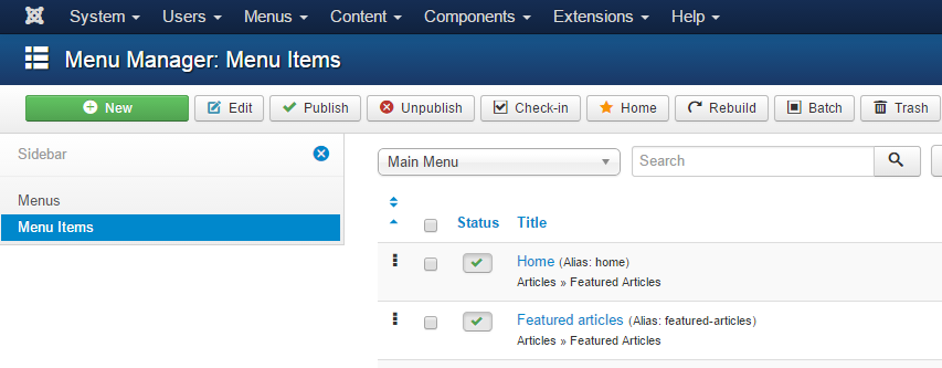

i visited your site, but i think that you have already added the sitemap to the footer menu. This is what i meant about using a standard menu item view for the HTML sitemap. What i mean is add a new item in your Joomla menu (see below)
The problem seems more related to the menu assignment of modules and menu in your Joomla site, if they are not assigned to the new menu item that could be the reason of missing elements.

Re:newbie questions Karma: 84
