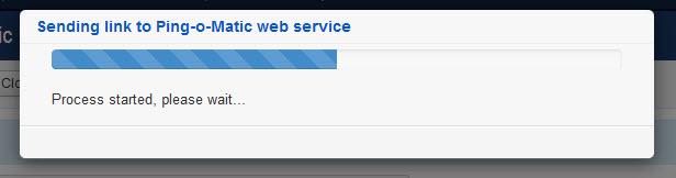

I installed, configured, and use JSitemap Pro on a Veteran Service Organization site (https://usncva.org). Everything works well except for the Pingomatic service. I set up pages to promote on various open sites but, when I click Send Pings, the service/function just hangs (see attached screenshot).
Thank you for your assistance!

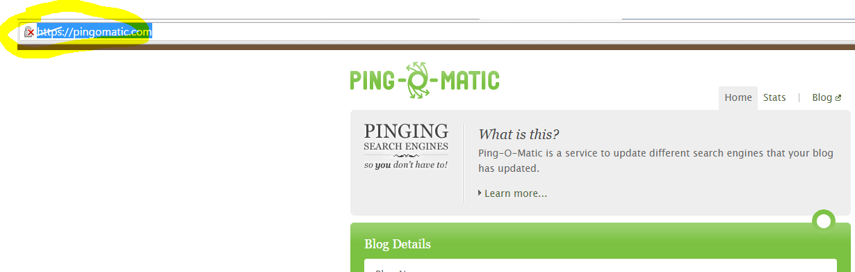

Hi Donald,
the problem is due to the fact that the Pingomatic website https://pingomatic.com/ has the SSL certificate that is expired (image visible below)
I contacted them reporting this, but they still have not updated the SSL certificate.
In this case to solve you have to navigate to the website https://pingomatic.com/ in your browser and grant access and an exception.
After that you can ping successfully on your site https://usncva.org
Even better, it would be adding a permanent exception in your browser for https://pingomatic.com/ so that you won't have to do this again in future.
