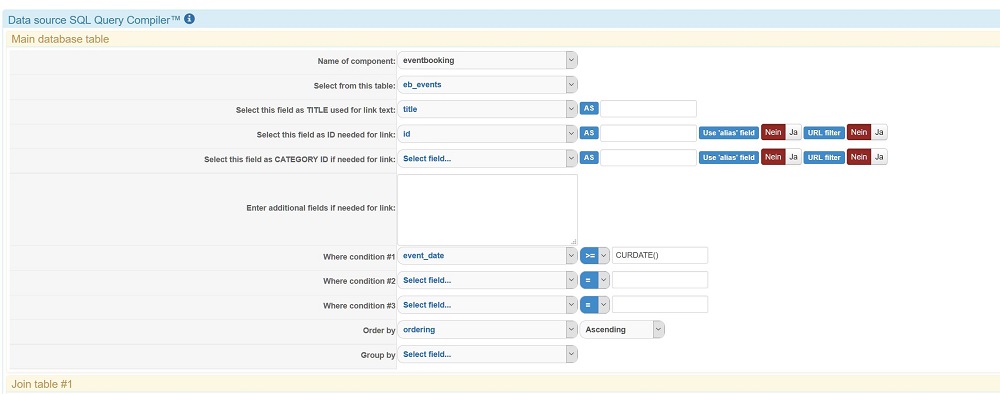

You are correct, if I take the code you wrote in the thread above, it works fine. I analyzed the code you sent and the code done by the Data source SQL Query Compiler. The compiler put out 'NOW()', where as correct would be NOW().
Using the compiler as shown in the picture below and then regenerate the output and delete the ' from the output around NOW() makes it work just fine.

Re:Event booking passed events Karma: 84
Hi Roger,
that's right and expected. When using the compiler to add NOW() the value is automatically escaped for security reasons to prevent SQL injection. So just remove the ' in the raw SQL string to have it working.
