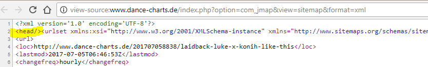

Some sitemap validator runs errors:
- Extra content at the end of the document on line: 2 column: 8
- error on line 3 at column 1: Extra content at the end of the document
- Line 2, Column 242: document type does not allow element "urlset" here
My sitemap: http://www.dance-charts.de/index.php?option=com_jmap&view=sitemap&format=xml

Please read the FAQ: https://storejextensions.org/faq/xml-sitemap-results-not-well-formatted.html
In your case you have a bugged plugin adding a '<head/>' tag, check if it's known and already reported in the black list at the FAQ page, otherwise once found it post it here please.

I noticed that it must have something to do with the cache.
Indeed if you open the first time a random param link the Joomla output for XML is not broken. http://www.dance-charts.de/index.php?option=com_jmap&view=sitemap&format=xml&nocache=99999

Thanks. That info helps. I excluded "com_jmap" from Joomla cache. Now it works fine.
