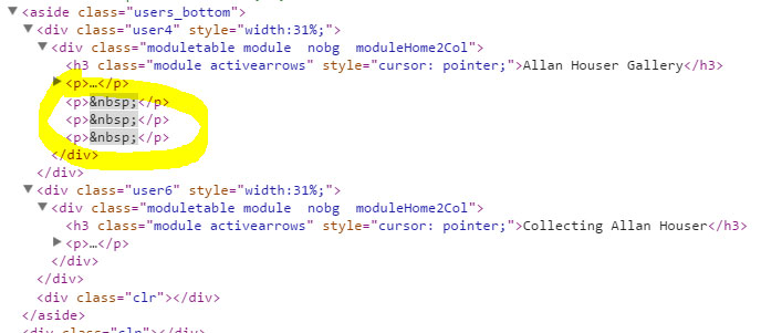

Please visit http://www.allanhouser.com on a mobile phone and scroll down. There are two modules with spacing issues. See ALLAN HOUSER GALLERY and COLLECTING ALLAN HOUSER. You can see the screenshot attached with a big space between the two modules. I tried adding various CSS to the Responsivizer Main.css file, like this:
.moduleblock1 { margin:0; padding:0; }
But it made no difference. I need to close the gap between these two modules. thanks, Hope

Greetings Hope,
i looked at your site but the problem is not about CSS, you have some extra empty <p> at the bottom of the first module that get space. You have to remove that empty paragraphs probably added inside the HTML of the module.

Re:Padding/Margins for Modules Karma: 0
Oh gosh. I meant to check that detail. I remember now that the border of the module was not wrapping properly without the extra <p> tags. Sorry for the trouble. I fixed it by adding more text. THanks so much for digging into the obvious, where I should have looked!
