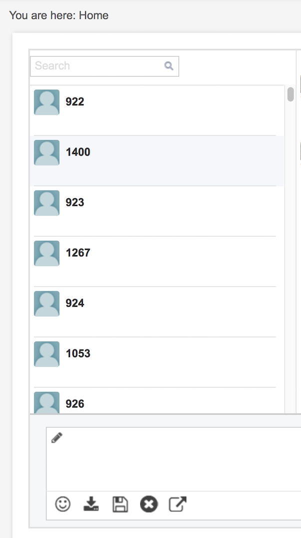

Thanks John,
I tried also to avoid the customization. I crossed my fingers each time I update JChat. Until now, I always took car of this.
The customization you gave me is for the online messaging, but not for the private messaging which could work off line. There is also the search filter on the list of users, as shown in the screenshot joined. It is this one I would like also to get for filtering on user_id.

Bertrand Couvin
Posts: 21
Re:Anonymous Users Karma: 0
Here is the screeshot
#7013
Posts: 3889
Re:Anonymous Users Karma: 84
The search filter in the private messaging works in a different way, it's based on javascript not on server side PHP.
I attach here a custom file to be replaced at root/components/com_jchat/js/messaging.js that perform the search based on the userid.
Take care to clear the browser cache after replacing it.

#7023
Posts: 3889
I checked deeper and tested a new messaging.js file successfully.
Use this latest one and it will work.
