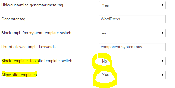

Hi John, I was experiencing the same issue (in J1.5) and fixed it per this thread (disabled Akeeba Admin Tools). However I would still like to run Admin Tools. Can you please provide a compatible setting that will allow the evaluator to work and the template changer script to run? Thanks!
#2118
Re:[SOLVED]Using Joomla 2.5.27, emulator problem Karma: 84
Hi Ross,
assuming that you have Admin Tools with the WAF controls, settings to allow dynamic templating as in the picture attached are required to make everything work normally.
